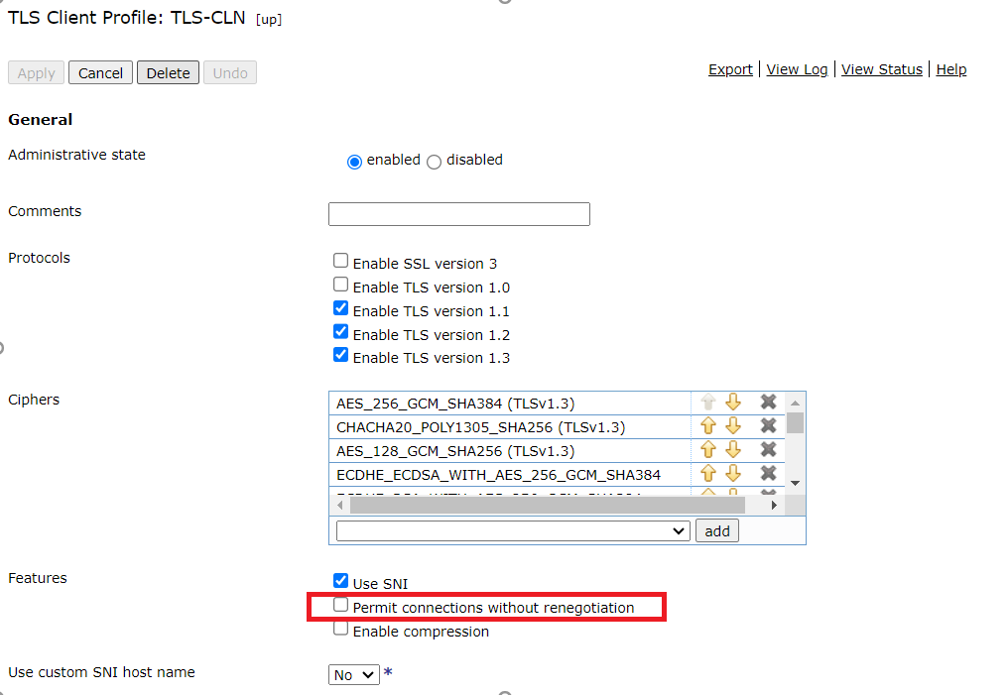

Permit connections without renegotiation in IBM API Connect v10
We need to enable the “Permit connections without renegotiation” option inside TLS client profile.
This option describes - Indicate whether a connection is successful when renegotiation_info is not included in the server response during the handshake. When enabled and a connection is successful, you do not know whether the server does not support RFC 5746 or whether the server configuration has renegotiation disabled. Servers that do not support RFC 5746 are vulnerable to man-in-the-middle (MITM) attacks as documented in CVE-2009-3555.
But after some time (every 20-30 min) even after enabling the option, it reverts to 'disabled' and the configuration rolls back to default.

    "Permit connections without renegotiation" is not configurable in API Manager. This can currently be achieved with a gateway-extension to select "Permit connections without renegotiation" in the associated TLS Client profile.
    https://www.ibm.com/docs/en/api-connect/10.0.x?topic=environment-extending-gateway-server-behavior

    We will leave it open till Dec 23, 2024 and if it has not received enough unique client votes then we will close it. For reference, This can currently be achieved with gateway extensions and is not under consideration at this time. We will continue to monitor voting for this idea with the potential to reconsider in the future.(https://integration-development.ideas.ibm.com/ideas/DPGWY-I-519)
