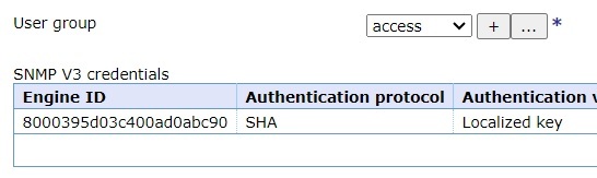

Firmware upgrade changes SNMP engine ID
Just wasted a couple of hours to realize the SNMP engine ID is updated with new firmware and the user account associated with the old engine ID had to be updated.  Even when you put "0" it will hardcode the current engine id meaning it will break next firmware

    Apr 17, 2024
    10.5.0.2 to 10.5.0.9 changed the SNMP ID
    10.5.0.9 to 10.5.0.10 didn't so it seems to have been fixed

    Apr 17, 2024
